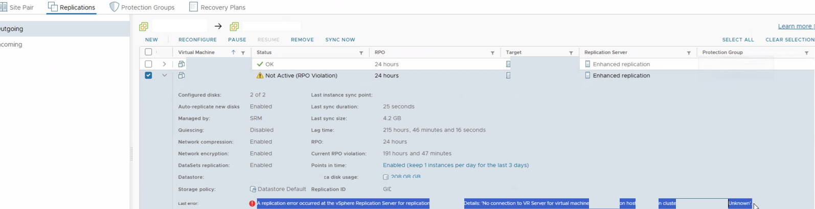

Symptoms:
  • vSphere Replication fails for multiple virtual machines, resulting in a Not Active (RPO Violation) status.The replication task details show the following error
    "No connection to VR Server for virtual machine on host."

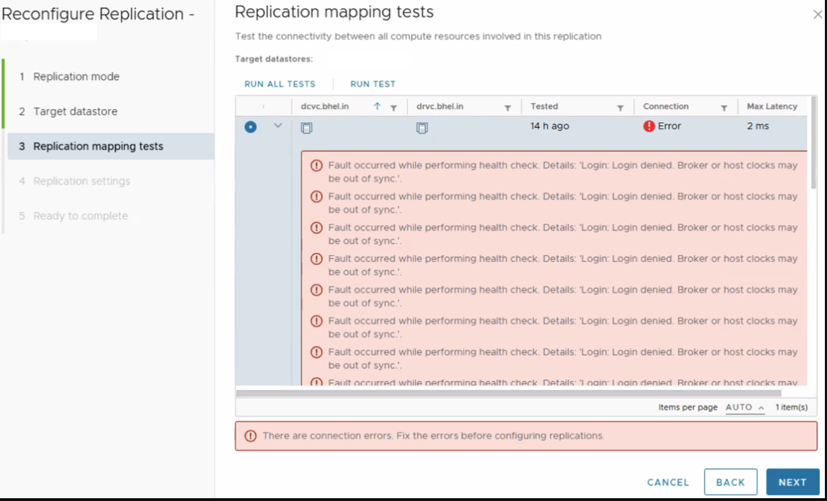

  • Attempting to configure replication or run a mapping test fails with below error
    Fault occurred while performing health check. Details: "Login Denied. Broker or host clocks may be put of sync".

  • This issue occurs due to time synchronization discrepancies between the vSphere replication appliances, vCenter Server, and ESXi hosts. This time drift prevents successful communication with the vSphere Replication service, leading to replication configuration task failures
