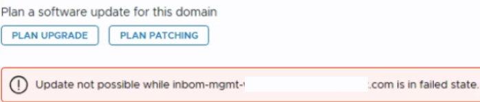

Getting error while selecting the version during plan patching : Update not possible when inbom-mgmt-####.com is in failed state.
