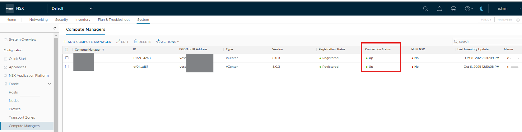

  2. Checking vCenter in NSX Manager
    NSX must recognize the same vCenter as a "Compute Manager" for the integration to function
    1. Log in to the NSX Manager UI (port 443).
    2. Navigate to System > Fabric > Compute Managers
    3. Locate the entry that corresponds to your environment.
    4. Note the following details:
      • Name/FQDN: The address listed under the Compute Manager column.
      • Registration Status: Must show as Registered.
      • Connection Status: Must show as Up.
    5. Click on the Compute Manager name to view its ID/UUID.
  3. How to Compare and Verify
    A mismatch in these settings is the primary cause of the "Unable to create network profile" error.
    • Endpoint Match: The FQDN/IP address registered in HCX (Step 1) must be the exact same vCenter added as the Compute Manager in NSX (Step 2).
    • UUID Consistency: If you are using the same vCenter but getting errors, ensure that NSX is not pointing to an old or stale registration of that vCenter (e.g., following a vCenter reinstall or certificate replacement). The vcuuid seen in HCX logs must match the UUID of the active Compute Manager in NSX.
    • Local vs. Global: Ensure that the NSX Manager registered in HCX (9443 > Configuration > NSX) is a Local Manager. HCX does not support registration with an NSX Global Manager.
