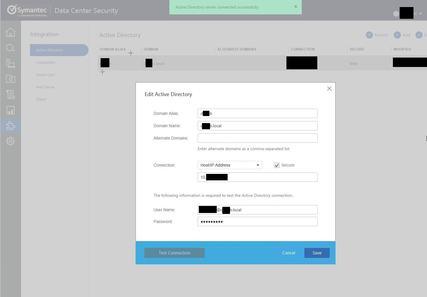

2. DCS Console > Integration > Active Directory and use below configuration as per your environment.
3. Click on 'Test Connection' to validate settings.
Note - You can also configure "non-secure" connection if the Active Directory is configured to serve on non secure port.

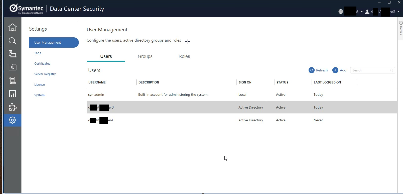

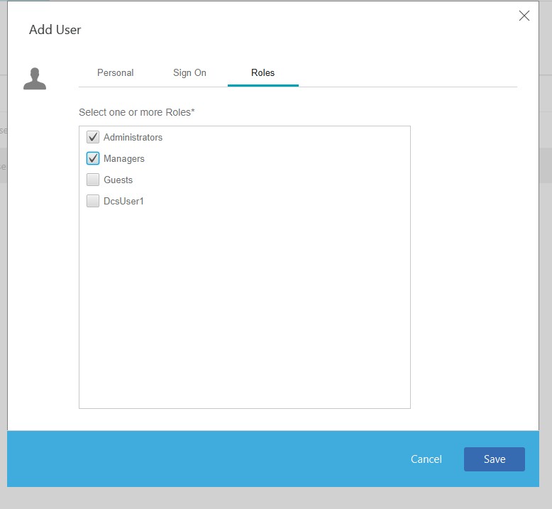

4. Go to DCS Console > Settings > User Management
Note- Select the 'Roles' as needed.

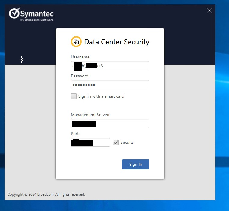

4. Test the configuration by logging to DSC console in below format -
