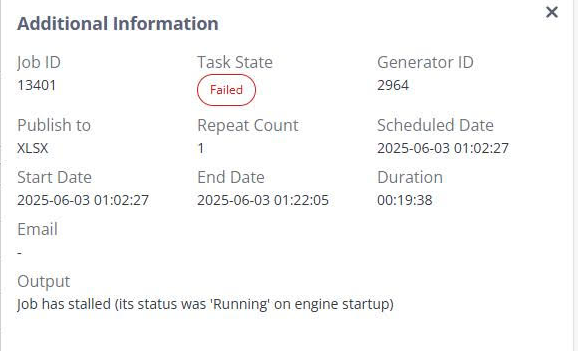

Post upgrade, while submitting existing data generation tiles, the job is running for days and not getting completed and it doesn’t shows any error while putting logs in DEBUG mode. This issue exists only for some of the generator tiles and others works fine.
Steps Followed : Tried recreating the same generator and submitted job and it completed successfully. Hence this happens for the some of the existing generators (sheets) which was created before the upgrade.
13401 Job was running for more than 18 minutes and then I stop the service to halt the Job.
TDM Portal 4.11.2009.0
Appling patch TDMWeb-4.11.2016.0.zip and later will resolve this issue.
