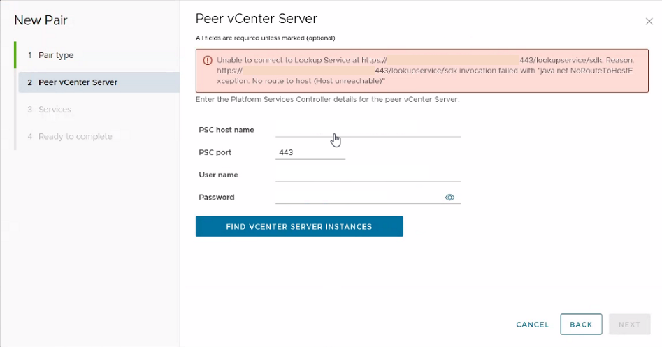

When creating a vSphere Replication site pairing, the following error is thrown:
Unable to connect to Lookup Service at https://vCenterIP-or-FQDN:443/lookupservice/sdk. Reason:
https://vCenterIP-or-FQDN:443/lookupservice/sdk invocation failed with "java.net.NoRouteToHostException: No route to host (Host unreachable)"
