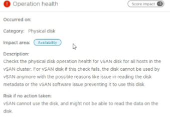

Symptoms:
  • vSAN Skyline Health reports Operational Health error for physical disks.
  • A vSAN ESA witness host reports a disk as unhealthy or unknown. Standard disk removal attempts fail due to locked metadata.
    esxcli vsan storagepool remove fails with Failed to invalidate disk metadata.
    vmkernel.log contains: WARNING: virsto: Log_VsanDiskLock:####: Failed to open device ####: Inappropriate ioctl for device

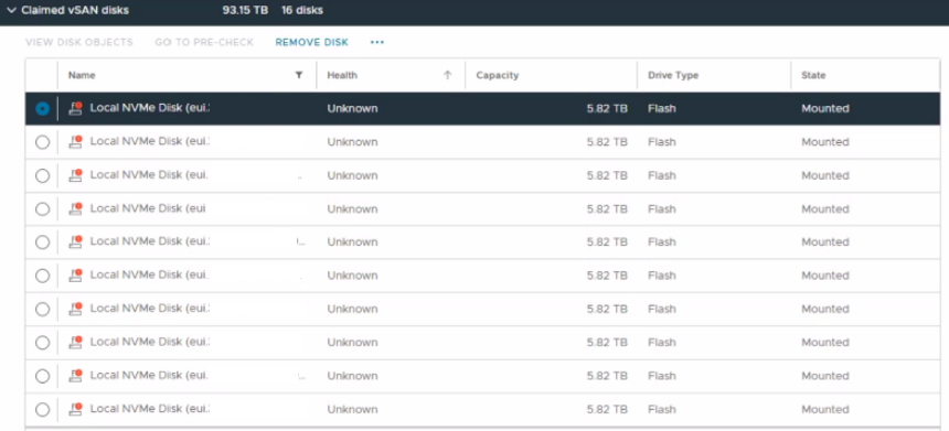

  • Navigate to vSAN cluster > Configure > Disk management. The disk status appears as "Unknown".
