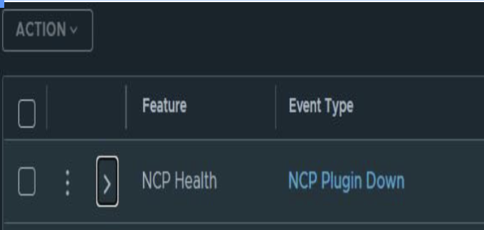

The "NCP down" alarm in the NSX alarm dashboard indicates that the NSX Manager is unable to communicate with the Network Container Plugin.
