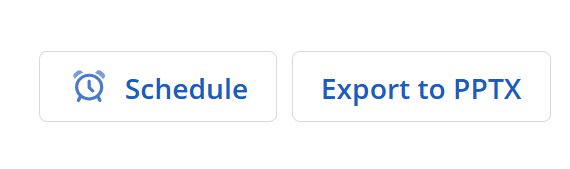

 In the new Reporting module, we should be able to export to PPT; however, we do not see this button appear in any sample reports we have created so far. We have adjusted access rights and had multiple users attempt, but still no luck.
- Log into New UX
- Click on Reporting from left Menu Option
- Click on the Report Designer Tab
- Click on the desire report
- Click on the on the "Layout" option on top
- On the Right Side - option for "Layout Format"
- Select the radio button for "Fixed" It will remove the "Maximum Width" from HD Display to: Letter & Portrait
- Published the Report
- Select the report and the export option will be available.
