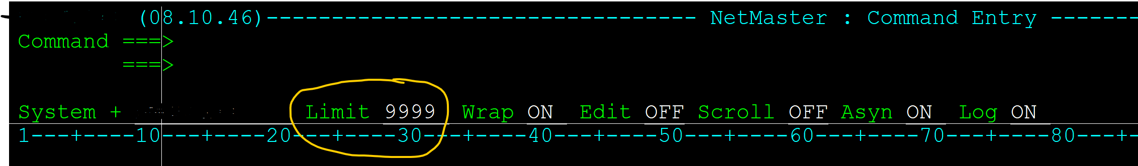

During our change we issued the SH DEFLOGON to find out what information was written to an application,
but we did not found it there, then I am really confused if I am doing the correct process and seeing the correct information.
The Limit on the Command Entry screen was set to 1000 and the output was larger so the information wrapped.
Increase the Limit on the Command Entry screen.
 Limit specifies the maximum size of the capture buffer
 before the Wrap option takes effect.
 Default: 1000
 Limits: 32767
