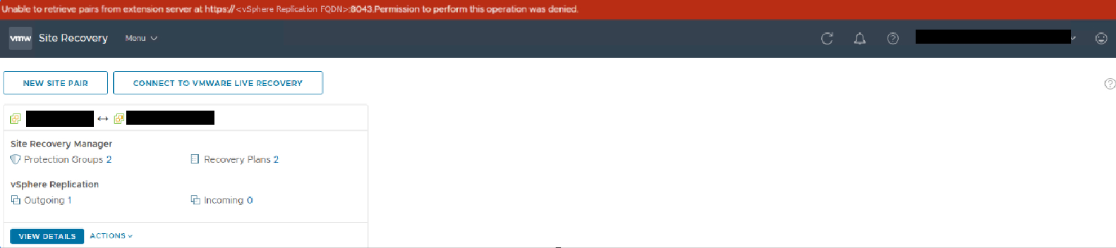

On launching the Site Recovery UI, following error is observed:
"Unable to retrieve pairs from extension server at https://<vsphere-replication-FQDN:8043. Permission to perform this operation was denied."
This issue is not observed when using the local vCenter administrator account.
The issue is only observed for users assigned with a new/old (modified) role which was supposed to give access to Site Recovery UI to perform DR operations.

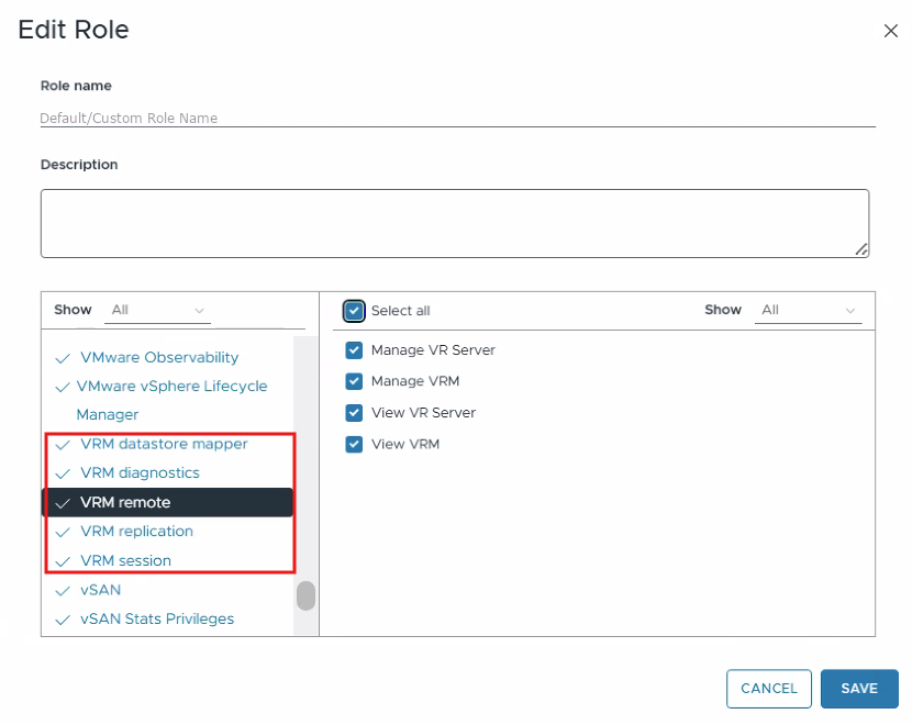

To resolve this issue:
Modify Role assigned to AD user by adding required permissions for vSphere Replication (VRM).
In vSphere Client > Click on Menu > Administration > Roles > Select the 'Role' assigned to AD user > Click on 'Edit'.
Add following privileges to the role:
VRM datastore mapper
Manage
View
VRM diagnostics
Manage
VRM replication
View replications
VRM session
Terminate

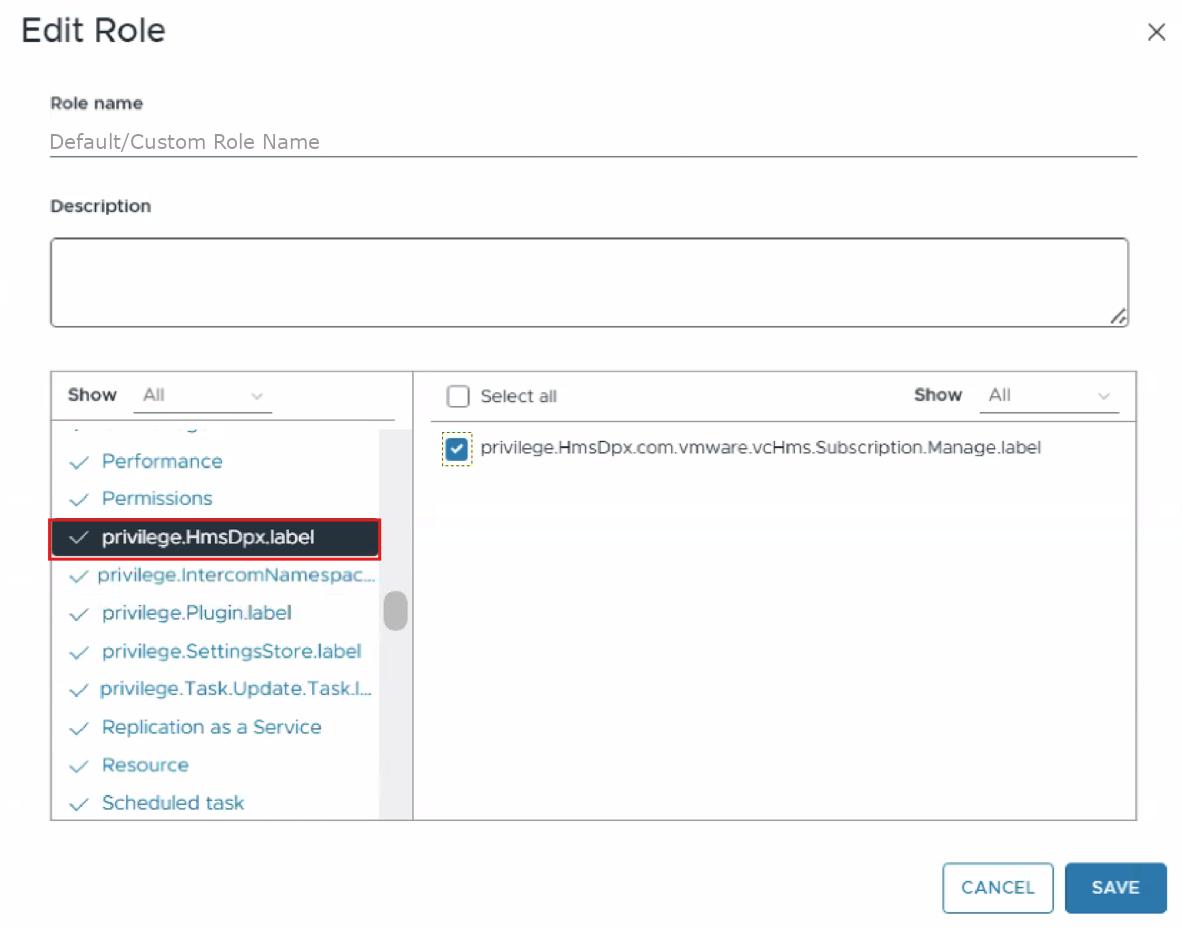

privilege.HmsDpx.label
privileage.HmsDpx.com.vmware.vcHms.Subscription.Manage.label
VRM remote
Manage VR server
Manage VRM
View VR Server
View VRM
Example:
Relaunch Site Recovery UI by clicking on 'Open Site Recovery' to validate resolution of issue.
