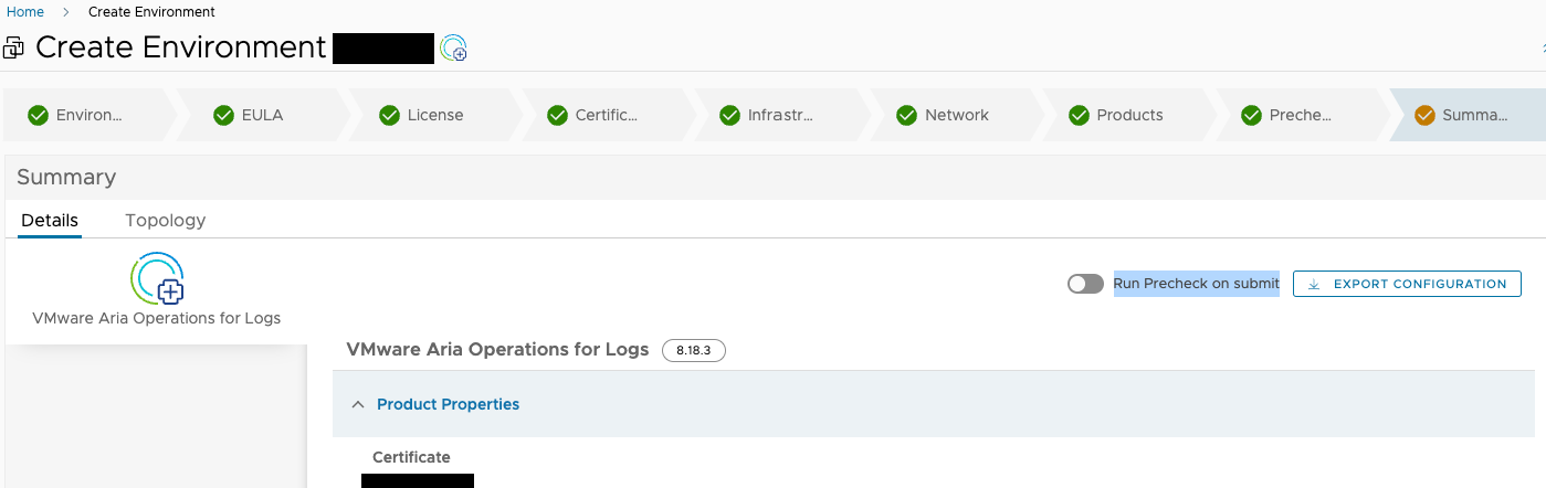

Workaround:
On the "Create Environment" wizard, disable the toggle for "Run precheck on Submit" on the "Summary" page:
