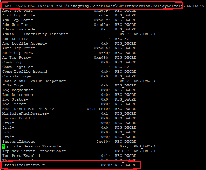

Aadd the below registry paramter "StatsTimeInterval" in the sm.registry file under the below registry path of the Policy server. Then stop / start the Policy serve services.
Below screenshot is reference configured for 120 seconds in hexa decimal value as 0x78.  The time interval is configurable value to print the stats time in seconds in hexa-decimal.
