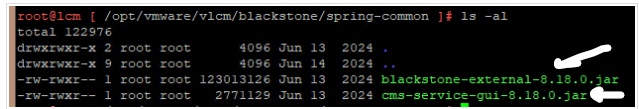

2: The jar files within  /opt/vmware/vlcm/blackstone/spring common show the incorrect version within their naming, versus the current running version of vRSLCM:
Example from lab:
1:  SSH to the vRSLCM appliance
2:  Edit using vi file  /etc/rc.d/init.d/launch-blackstone-spring
 "VERSION" line to match the version that vRSLCM is currently running  (Example:  VERSION=8.18.0)
3:   Re-name the two files within /opt/vmware/vlcm/blackstone/spring common
so that their "version" matches what vRSLCM is currently running and what is showing
in  /etc/rc.d/init.d/launch-blackstone-spring "VERSION" line:
Example:   blackstone-external-8.18.0.jar
