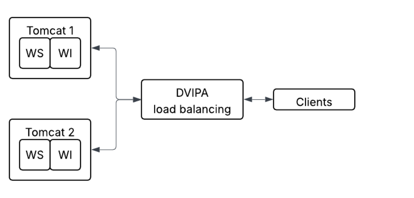

A sysplex with Tomcat running on each Lpar - Endevor Web Services and Web Interface reside in the same Tomcat, HA is enabled for Tomcat using DVIPA.
User can log onto the Endevor WebUI and select packages but after a few random packages (and random time lapse), user get bounced back to the log on page.

On login into Endevor WebUI, it creates JSESSIONID cookie which binds to a specific WebUI instance/address space. With the current DVIPA routing (by default dvipa does round robin load balancing), it switches to another instance of EWI where the session cookie from the first instance is not valid. For EWI application it's important to establish application affinity when it has HA configuration with DVIPA. In other words, the client who started connection to the EWI, always should connect to the same application in order to keep the same session.
Split the Web Services and WebUI applications:
  • Endevor web services Tomcat in HA mode, keep it as it is, on the same DVIPA.
  • Endevor web interface Tomcat in HA mode, on a separate DVIPA with TIMEDAFFINITY (30 seconds or 60 seconds)
