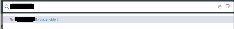

  • From Aria Operation, the Placeholder VM appears as "Duplicate Not Found".
  • The Placeholder VM appearing '"Duplicate Not Found" in Aria Operation, has status set 'unset' in MOB of vCenter server hosting the Placeholder VMs.
    This Indicates the placeholder VM is stale and lost connection to Site Recovery manager.
  • Placeholder VMs which is running good and not appears with "Duplicate Not Found" in Aria operation as below,
    The parameter "ManagedBy" as per screenshot will appears with link.
    This Shows the placeholder VM is still has connection with Site Recovery manager and valid placeholder VM.
  • The above two screenshots shows difference in placeholder VM configuration, Active/Valid Placeholder appears as below,
    The affected or stale placeholder appears as below, appears with Missing extension (placeholder).
