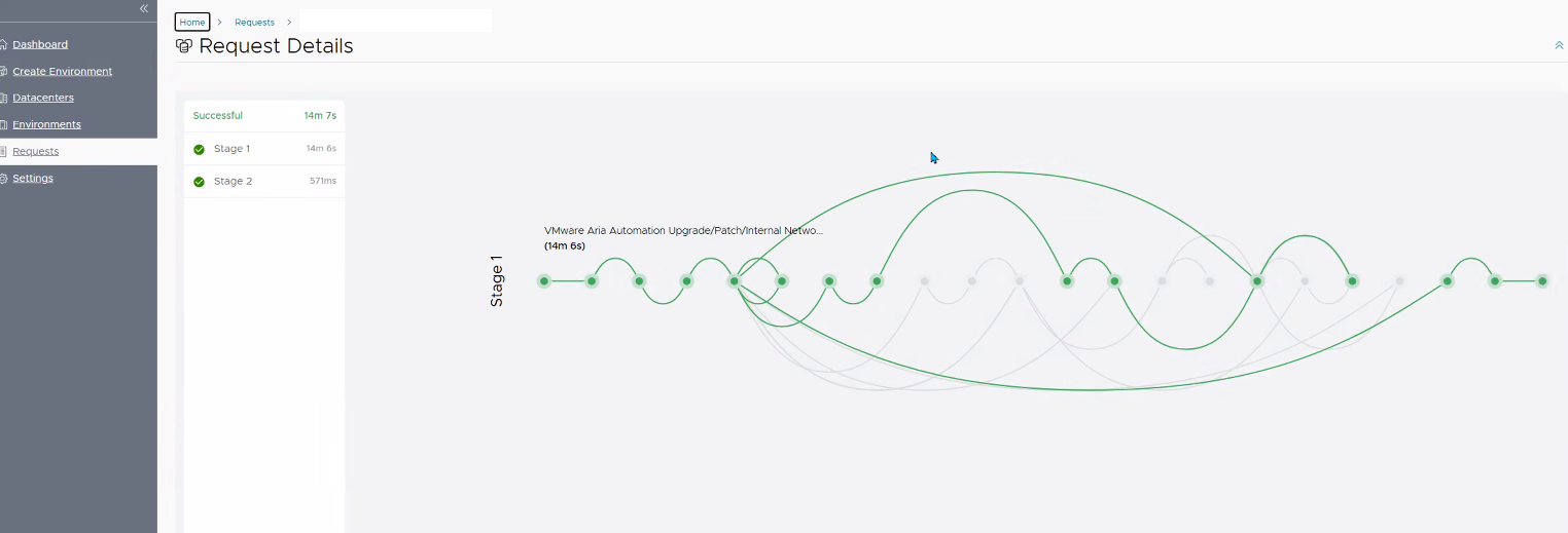

  • Aria Automation patch installation completes prematurely, and the patched version is not reflected in the environment, despite multiple attempts.
  • In the VMware Aria Suite Lifecycle UI, the request status misleadingly shows as completed successfully, masks the deployment failure, and reports a false positive state.

  • Initially, the LCM Product Patch Install request may complete in an unusually short time (13 minutes 42 seconds), indicating a problem
