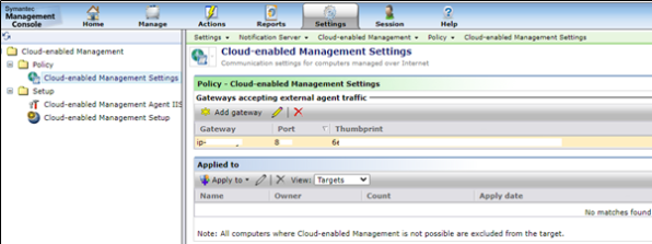

  3. Configure one or more Cloud-enabled Management Settings policies in the SMP console
    • Navigate to Settings > Notification Server > Cloud-enabled Management > Policy > Cloud-enabled Management Settings
    • Add the new internet gateway. Specify externally resolvable FQDN, port for agent communication to the internet gateway (443 default), and the IG certificate thumbprint captured in step 1.
      Note: add an additional entry for the gateway by external IP address with the new thumbprint just to make sure that your CEM clients can reach the new Internet Gateway by FQDN and/or IP Address. After the CEM connection has been validated, you can remove the IP Address entry from your Cloud-enabled Management Settings policy if you want.
    • Apply the policy to any agents you wish to test CEM on them. An agent must be targeted by at least 1 CEM policy for them to communicate off of the LAN through CEM.
    • For any agents who are not able to receive the policy, an offline CEM installation package can be generated from Settings > Notification Server > Cloud-enabled Management > Setup > Cloud-enabled Management Setup. The offline installation package can then be delivered to the machine through an alternate method of your choice. The offline package has the ability to automate certificate distribution which is recommended.
    • Enable/turn on the policy
