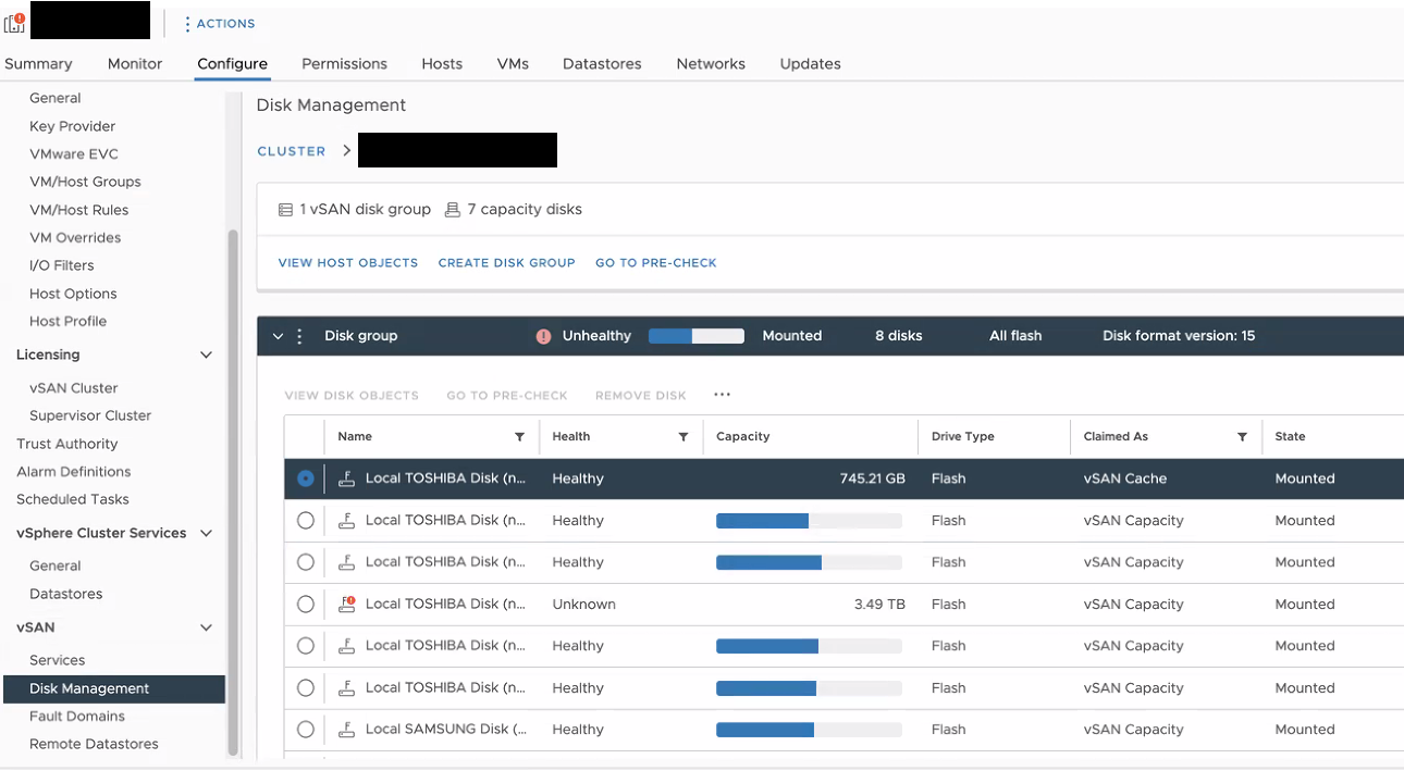

Symptoms:
  • One or more disks have failed in a vSAN cluster and requires replacement.
  • Below error is  reported in vCenter UI under Cluster>Configure>Disk Management
