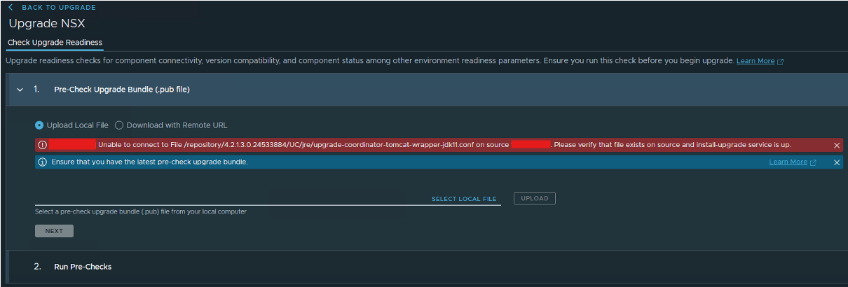

  • Trying to upgrade to latest build, getting the following error:
    "Unable to connect to File /repository/4.2.1.3.0.24533884/UC/jre/upgrade-coordinator-tomcat-wrapper-jdk11.conf on source <Source-IP>. Please verify that file exists on source and install-upgrade service is up."

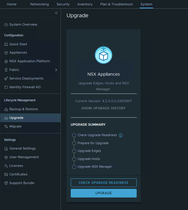

    6. Go back to UI and navigate to the upgrade section.
    7. Upload the upgrade bundle again.
