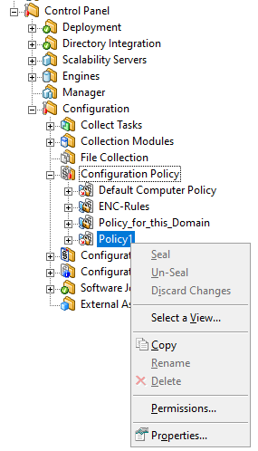

When trying to unseal a Configuration Policy following error occurs :
The server failed to seal or unseal the policy. Click help for more information (CFM233494)
On the left, right-click context menu have options Seal and Un-Seal greyed out
Client Automation - All Versions
The configuration policy has a small red arrow icon indicating it comes from Enterprise server.
Configuration policy created at Enterprise level could not be unsealed at Domain level
If the configuration policy must be updated, modification should be made at Enterprise level.
Once sealed again the modifications will be replicated automatically to all Domains linked with the Enterprise.
If the modification must be done for only a specific Domain, create a new configuration policy at the Domain level. Do the modification in the local configuration policy, seal it and copy the configuration policy to the Domain Manager.
