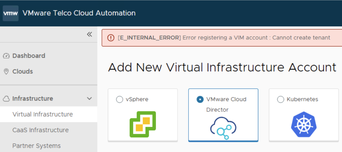

Error "[E_INTERNAL_ERROR] Error registering a VIM account : Cannot create tenant" is received while adding virtual infrastructure (VI) vCloud director endpoint on Telco cloud automation
Article ID: 398158
VMware Telco Cloud Automation VMware Telco Cloud Platform
  • Unable to add a virtual infrastructure (VI) vCloud director endpoint on Telco cloud automation, it fails with the error message
    " [E_INTERNAL_ERROR] Error registering a VIM account: Cannot create tenant"
  • Manually registering a new vCloud Org and deleting the newly created vCloud org works fine
  • Identify the endpointId from TCA log
    /logs/pods/tca-mgr_tca-api-xxxx/tca/1.log
    [{"username":"[email protected]","tenantId":"default","enterprise":"DEFAULT","organization":"DEFAULT","userRoles":["8bb14097-f062-40ab-a60b-aed654c1c05c"],"endpointId":"20241218055144355-6a8565f7-88ed-413a-a14f-3e785ccde8d4"}],"tenantIds":["default"],"severity":"INFO","userIdentity":{"username":"[email protected] "},"eventId":"d49e3f59-f39c-4d27-817e-559004702037 ","eventTime":1743755269594,"message":"Authentication success","restEndpoint":{"uri":"\/tca\/vim\/api\/v1\/orgs\/default\/vims","method":"POST","sourceIPAddress":"10.191.xx.xx"},"requestParameters":{"query":[],"sessionId":"964cb1ee2e1158c3119fe052c0d6052f1ae400e17c9686102928eae36deac2c1"}}
TCA: 3.2.x
TCP: 5.0.1
This issue occurs when there are stale entries from the past unsuccessful or incomplete registrations present in the TCA database.
Remove the remnant entry from an earlier unsuccessful/incomplete registration job from the TCA database. Once removed, proceed and continue with the VIM registration flow.
