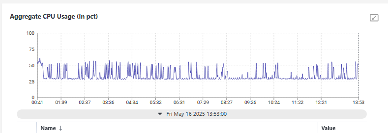

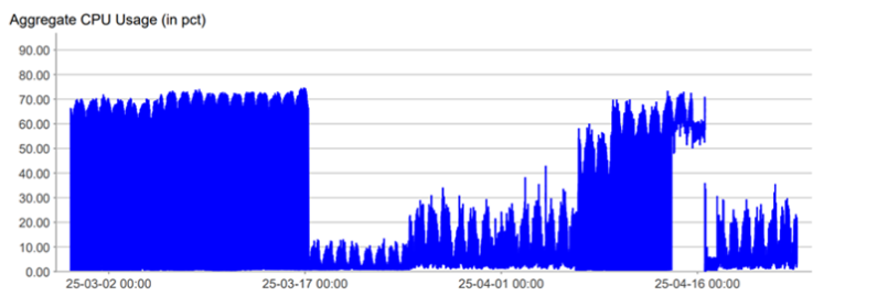

We are building some Metric Viewer graphs and when showing raw data (Aggregation Interval equals to Raw) the graph does not shows a line, but it shows like in the screenshots below:
DX UIM 23.4.3
The "Raw" data option in the graph literally shows every datapoint for a particular metric object.
If the QOS interval is very low (Example 1 minute) the graph will show every data point, and for higher time ranges it shows and connect all the datapoints and the graph tries to fit them all in the graph, so it can become hard to read.
Use different aggregation intervals for showing a cleaner line
