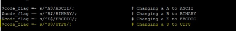

The "COMMAND FAILED" and CODE_FLAG errors are related to the code used in the xcompp.pl script for the 2nd transfer. The user added code is processing the code_flag from the 1st transfer i.e. received values of 'A', 'B', 'E', are respectively converted to 'ASCII', 'BINARY', 'EBCDIC' for use on the 2nd transfer:
So currently a value of '8' is not being handled and an extra line of code needs to be added to do that and convert it to 'UTF8'
The post-processing script was corrected to handle the value of '8' and CODE=UTF8 was then used for both transfers.
