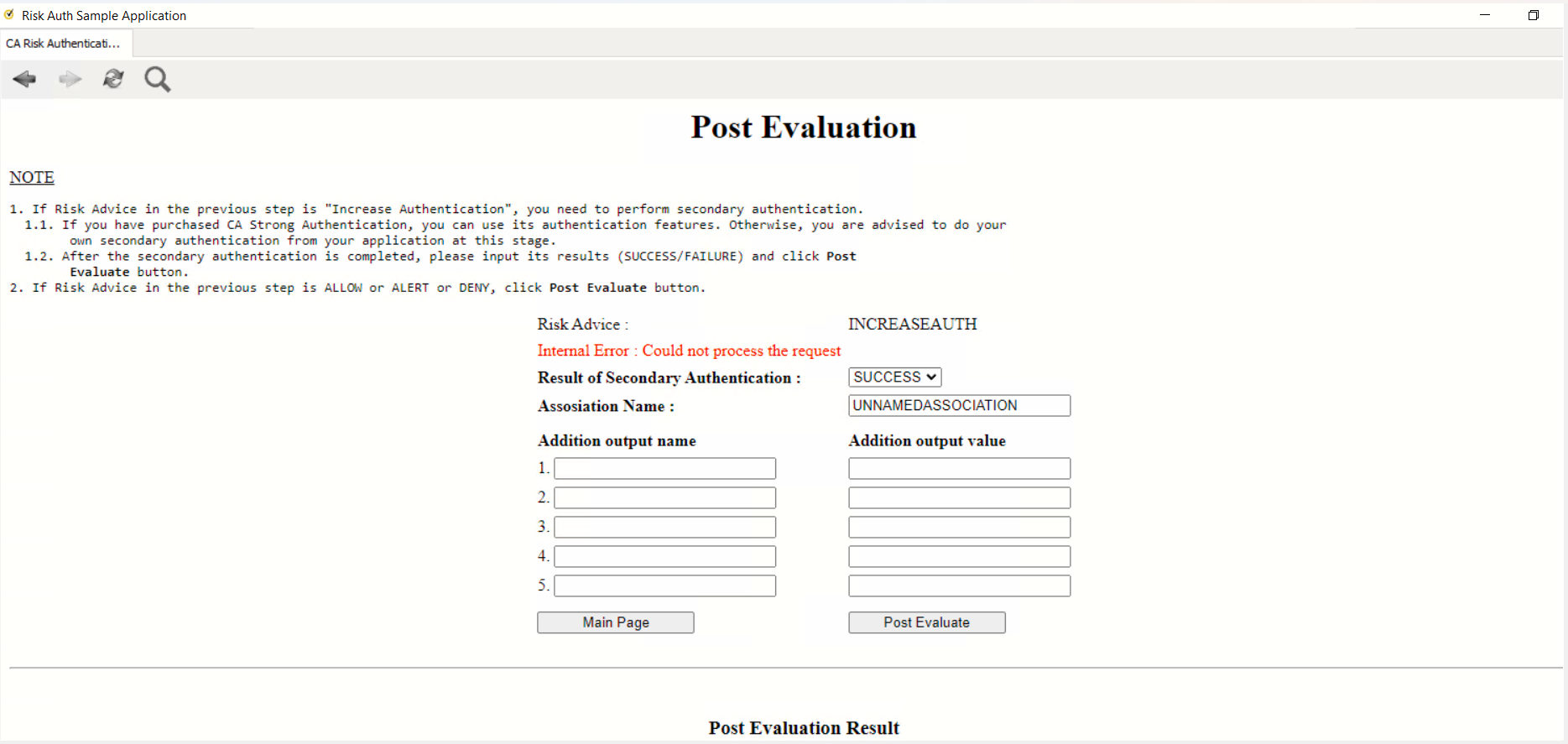

In Risk Authentication sample application, post evaluation operation is failed with the error 'Internal Error could not process the request'.
