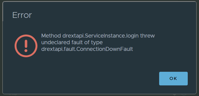

  • Certain SRM adapter instances fail to connect with the SRM server. The following error can be seen for the SRM adapter accounts:
    • Method drextapi.ServiceInstance.login threw undeclared fault of type drextapi.fault.ConnectionDownFault
  • The /storage/vcops/log/collector.log event shows the following:
    • 2025-04-28T02:17:39,693+0000 WARN [Collector worker thread 23] com.vmware.srm.vrops.SrmAdapter.onCollect - Failed to create authenticated srm factory com.vmware.vim.binding.vmodl.fault.SystemError: Method drextapi.ServiceInstance.login threw undeclared fault of type drextapi.fault.ConnectionDownFault
