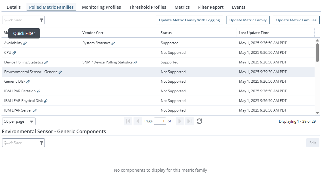

We recently upgraded our DEV environment to 24.3.8 which includes certifications of NetGuardian G5 devices.
Post the upgrade we discovered couple of G5 devices in our DEV environment but we are not able to see the components getting discovered in Performance Management which were included in the certification request.
We need some help in modelling these NetGuardian devices correctly in PM and monitor the certified components for performance metrics.
Newly discovered G5 where metric family (Environmental Sensor - Generic) says unsupported:
