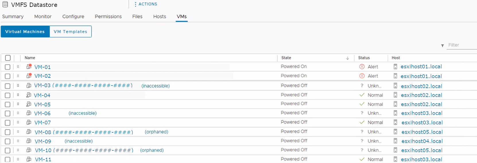

Symptom:
  • VMs on the datastore are showing up as inaccessible and orphaned state.
  • Storage vmotion fails with an error "Cannot complete file creation operation."
Validation:
  • VMs seen from the vCenter on the datastore are just stale entries. There are no VM files on the datastore.
    SSH to the ESXi host and navigate to the VM directory. No files are present on the datastore -
    [root@esxihost01:/vmfs/volumes/<UUID of Datastore>/<VM Folder>] ls -l
    total 0
