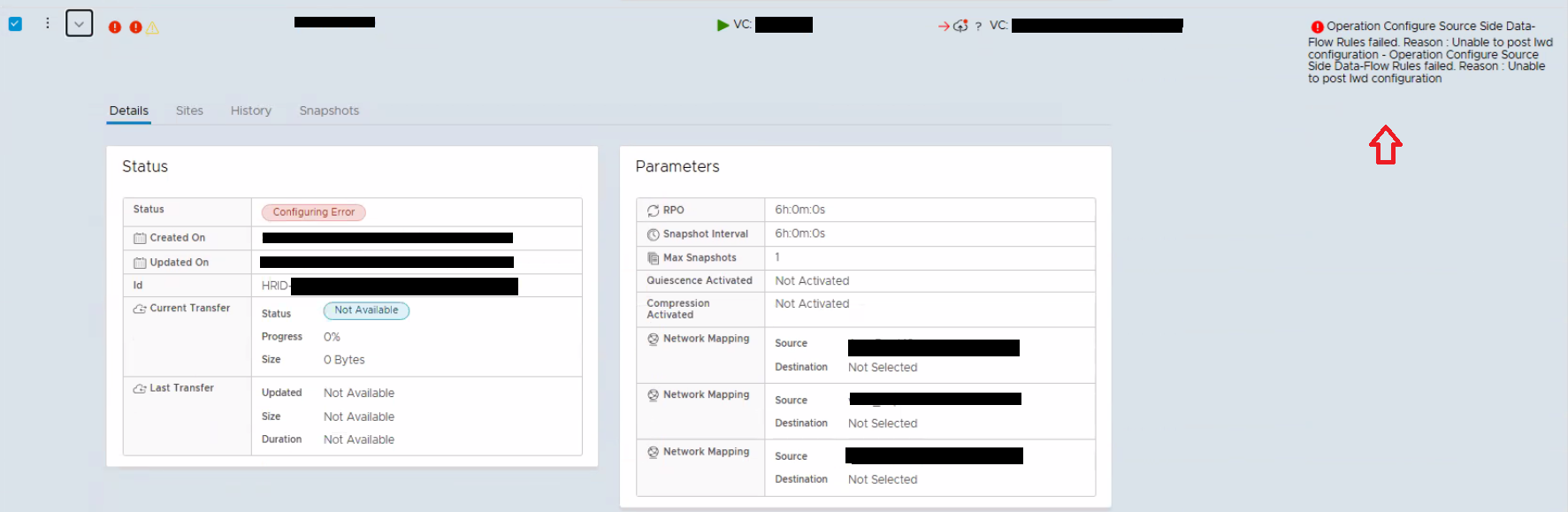

  • Operation Configure Source Side Data- Flow Rules failed.
    Reason: Unable to post Iwd configuration - Operation Configure Source Side Data-Flow Rules failed. Reason: Unable to post lwd configuration
  • When checking the VM directly on the vCenter, you may also notice the below configuration issue: "No Connection to VR Server: Unknown".
    Note: This error can be observed across multiple different scenarios.
