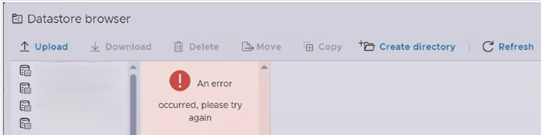

Although the datastore appeared as mounted in the vCenter UI, upon verifying directly through the ESXi host UI, the following error was observed:
An error occurred, please try again.
Ensure consistent storage visibility across the cluster by mounting the required shared datastores on the destination ESXi host via the host UI.
