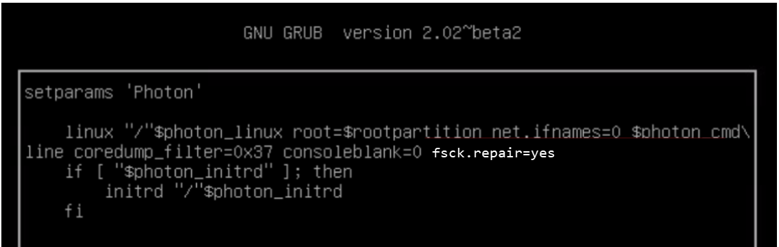

1. Reboot the virtual appliance, and immediately after the OS starts, press 'e' to open the GNU GRUB Edit Menu.
2. Locate the line that begins with the word linux.
3. At the end of the line, add fsck.repair=yes then press F10 to continue booting the appliance. This will force the filesystem to check and auto-resolve disk issues.
After performing the above-mentioned steps retry the upgrade.
