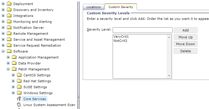

  2. Create a Custom Severity value in Core Services for patch:

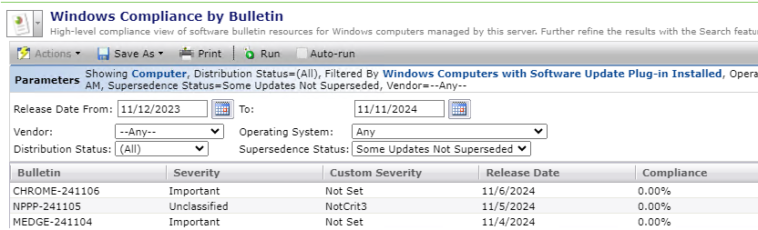

  3. Log in with this user account to console and open Compliance By Bulletin.
  4. Assign custom severity to a few random bulletins. In this sample, you have assigned NotCrit3 to NP++.

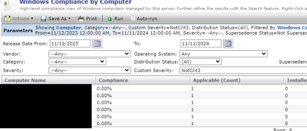

  5. Then open Windows Compliance by Computer, where you can specify the Custom Severity parameter, and set it to our custom value so the report would have filtered results:

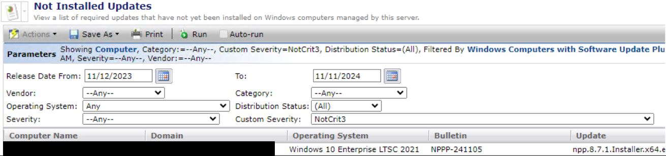

  6. Then if you go into any sub-reports (drill-down) and select Applicable, or Not Installed, etc - the custom severity parameter is pre-configured (which seems to be expected - as it's also visible as configure-able).

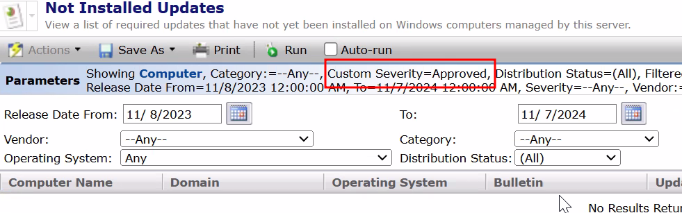

  7. Yet then if you go into another report - Compliance By Bulletin (which does not have this custom severity parameter configurable):
  8. And select another bulletin without set custom severity:
  9. You would end up with 0 results since these parameters have filtered the expected results.
