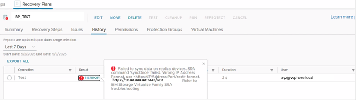

  • Test recovery fails with the error:
    SRA command 'syncOnce' failed. Wrong IP Address Format, use https://IPAddress:Port/rest format.
Remove IP from snap
  • Additionally, the array pair status is in a failed state.
  • The "Discover Devices" operation also fails with the same error:
    SRA command 'discoverDevices' failed. Wrong IP Address Format, use https://IPAddress:Port/rest format. Example https://10.##.###.##:7443/rest. Refer to IBM Storage Virtualize Family SRA troubleshooting.
