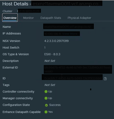

  • In an NSX environment, one or more ESXi host Transport Nodes display a 'Degraded' status. However, upon reviewing the node details, all underlying components and services report an 'UP' state.
  • Host status reporting it as "Degraded".
  • View Details shows everything as green and UP.

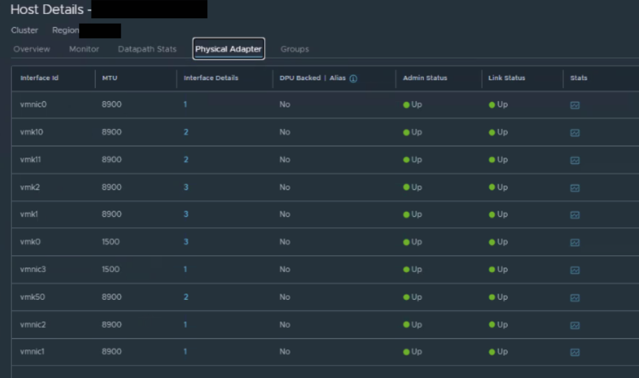

  • Physical uplinks shows up and connected status:

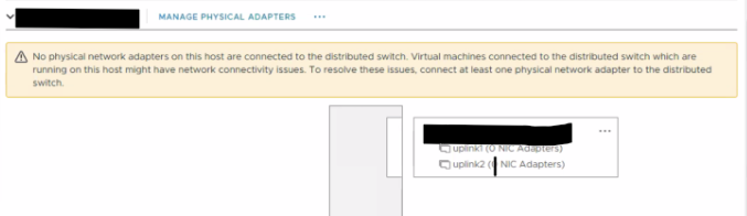

  • Similar errors will also be reported in the ESXi, if there are no uplinks associated with the VDS (Path: Login to vSphere UI--> Go to the problematic ESXi host-->Configure--> virtual Switches.).

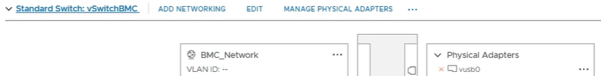

  • A 'Degraded' status may be reported in the NSX UI if the ESXi Transport Node is configured with a virtual vmnic for vUSB0 and experiences a vUSB connection "down".

  • Uplink Verification: Ensure that all configured uplinks on the ESXi host transport node are active and fully operational.
  • Cleanup Unused Uplinks: Remove any faulty/ misconfigured uplinks from the Distributed Virtual Switch (DVS) post validating the configuration. These changes required host maintenance.
  • vUSB0 Management: Delete the vUSB0 interface if in case it is not required within the environment. These changes required host maintenance.
