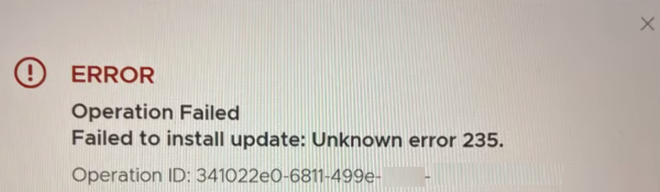

Symptoms:
  • When upgrading vSphere Replication through VAMI, user sees "Operation not permitted: The connection was closed by the remote end during handshake"
  • Also, upgrading the appliance via the Appliance Management Interface (VAMI) fails, displaying the error message: "Operation Failed Failed to install update: Unknown error 235."
  • Looking in the ./vmware/support/logs/dr/drconfig.log log file, you see "Unknown error 235" and references to an incorrect rpm file.
