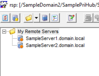

  • Create a new entry in the config file containing these profiles:
    <folders>
       <My Remote Servers>
          0 = SampleServer1.domain.local
          1 = SampleServer2.domain.local
       </My Remote Servers>
    </folders>

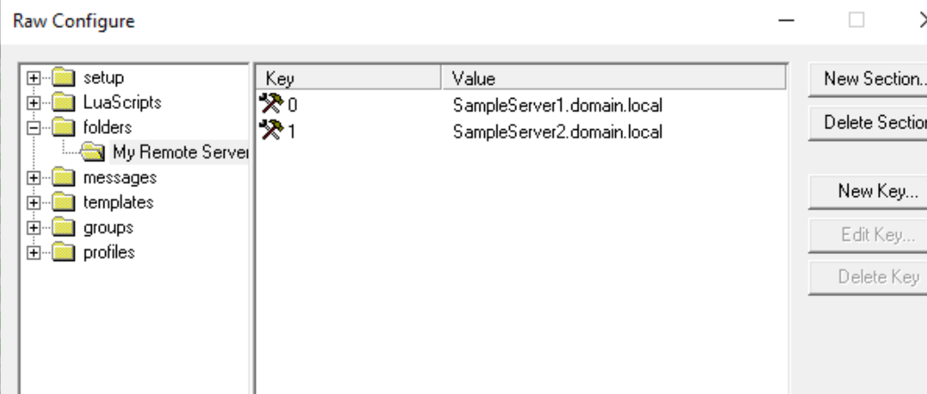

  • You can also do this in Raw Configure.
  • The result in Raw Configure should look like this:
  • Deactivate/Activate the probe and the folder tree should be recreated.
