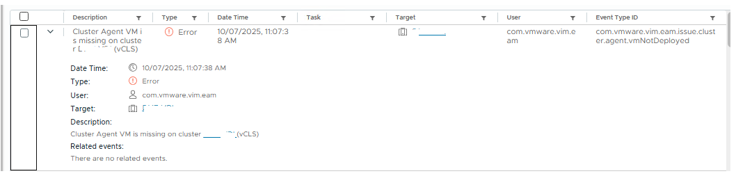

Symptoms:
  • In the vCenter Server events of the affected cluster, you will see the below event:
Cluster Agent VM is missing on cluster <Cluster Name> (vCLS),Error,com.vmware.vim.eam,com.vmware.vim.eam.issue.cluster.agent.vmNotDeployed
