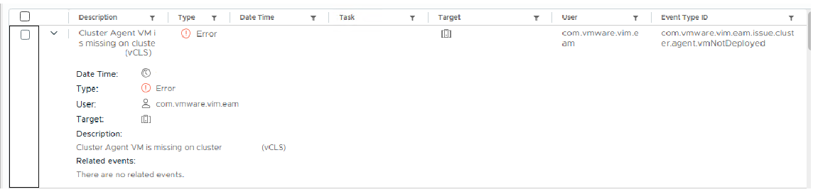

The vSphere cluster reports errors indicating that Cluster Agent VMs are missing, affecting the health of cluster services.
  • In vCenter Server events, the following error appears: Cluster Agent VM is missing on cluster (vCLS), Event Type ID com.vmware.vim.eam.issue.cluster.agent.vmNotDeployed.
  • The vSphere Cluster Services health status is reported as Degraded.
