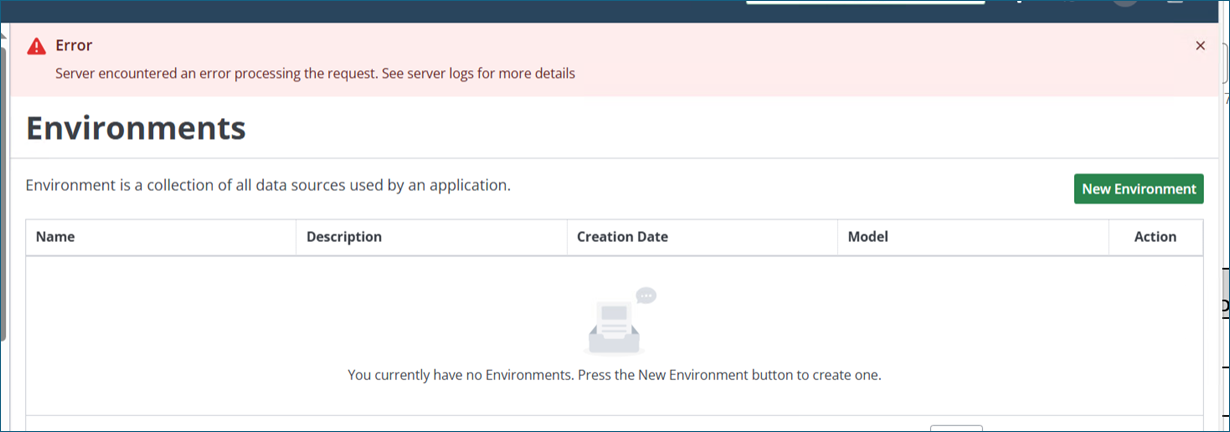

Installed TDM Portal version 4.11.159 from 4.10, after logging into the Portal, getting below error when creating a new environment:
All supported TDM environments.
The problem seemed to be the OrientDB was offline, the screenshot shows that TDM isn't finding the environment.
