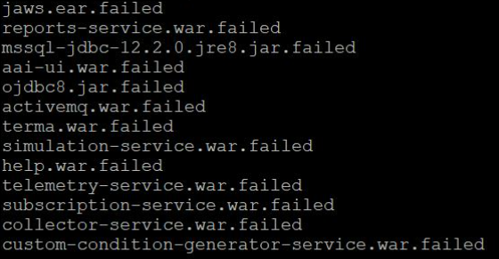

The deployment of the AAI microservices are failing with the error message in the failed *.war or *.jar file.
"WFLYDS0022": Did not receive a response to the deployment operation within the allowed timeout period[7200 seconds]. Check the server configuration file and the server logs to find more about the status of the deployment.
Within the deployments directory:
