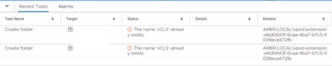

  • In the vCenter Recent Tasks, the error "The name 'vCLS' already exists" is observed repeatedly.
