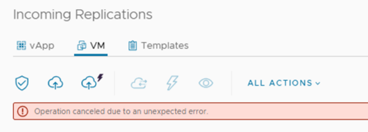

  • Unable to protect/replicate certain virtual machines in VMware Cloud Director Availability(VCDA). Configuring protection fails with following error:
