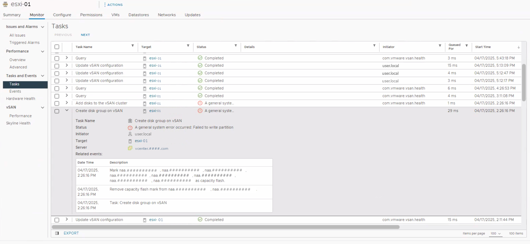

Symptom:
  • Creating a disk group throws an errror "A general system error occurred. Failed to write partition".
