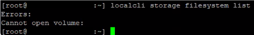

  • Unable to see the datastore from the vSphere client UI or ESXi host GUI.
  • Unable to see the datastore mounted on the ESXi host from the ESXi host CLI.
    esxcli storage vmfs file system list
  • The Log files fails to load,
  •  Running the 'esxcfg-mpath' command in the ESXi host CLI does not display any paths for the datastores.
