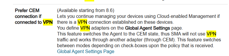

You are using the following Setting:
"Prefer CEM gateway connection if VPN connection is established"
You can find more details on how it works under:

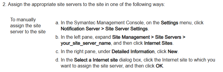

Make sure SS-cloud.mainExampleDomain.com is part of the displayed servers under the "Servers" tab on your Internet Gateway Manager UI and it can communicate under the specified port (by default port 4726).
