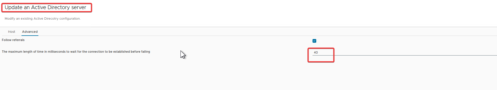

To workaround the issue :
  • We can increase the maximum time to wait for the connection establishment from the default 20 milliseconds to a higher value by running Update an Active Directory server workflow from Aria Automation Orchestrator and update the timeout from the Advanced tab. Refer documentation Configuring the Active Directory Plug-In
  • If the issue persist even after increasing the wait time, implement the client side load balancing such as Round Robin or Failover method by following the documentation Client-Side Load Balancing for the Active Directory Plug-In
