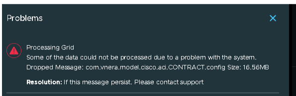

When you log in the UI and select Settings / Infrastructure and Support on the lower part of the page on the Platform node(s) you see the following error:
Processing Grid
Some of the data could not be processed due to a problem with the system.
Dropped Message: com.vnera.model.cisco.aci.CONTRACT.config Size: 16.56MB
Resolution:  If this message persists, Please contact support.
Refer to screenshot below:
