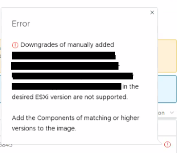

When attempting to update ESXi hosts with vLCM using the single image option, the following similar messages appear when reviewing Image Compliance:
  • The "Check Compliance" status for the ESXi host returns "Incompatible" on vLCM.
  • When attempting to remediate or check compliance of an ESXi host against a vSphere Lifecycle Manager (vLCM) cluster image, the process fails with errors:
    Downgrades of host VIBs <name>(<version>) in the image are not supported.
    Add the components of matching or higher versions to the image.
  • When transitioning a VCF cluster from Baselines to vLCM Images using the VcfBaselineClusterTransition.ps1 script, the process fails during the compliance check phase with a DRAFT_CREATION_FAILED error. The generated resource-compatibility.json file displays INCOMPATIBLE components with error as below:
    Downgrades of manually added Components <name>(<version>) are not supported.
  • When upgrading esxi hosts via VCF Operations the upgrade precheck fails with result Host is not compatible with the image.
    Result: Downgrades of host VIBs <name><version> in the image are not supported.
    Remediation: Add vendor Addon and Components that include matching or higher version VIBs to the image.
