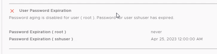

VIDM health shows unhealthy due to expired "root" and/or "sshuser" password.
VMware Identity Manager 3.3.7
The "root" and/or "sshuser" passwords have expired, and need to be reset.
Follow the below steps to change the expired password for the corresponding local account (in the above example, the "sshuser" local account password has expired):
