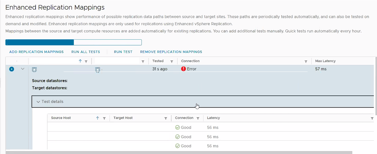

  • Enhanced Replication Mappings throws following error:
    "Fault occurred when performing health check. Details: 'Connect: certificate verify failed (SSL routines)":
  • In some cases, the enhanced replication mappings will be in error state, but all the connections return a status of good on the site recovery UI. However, /opt/vmware/hms/logs/hms.log file, reports below errors.

  • VMs configured for replication using enhanced replication enters a Not Active state
  • ESXi hosts and the vSphere replication appliance uses custom signed certificate and certificates are renewed recently
